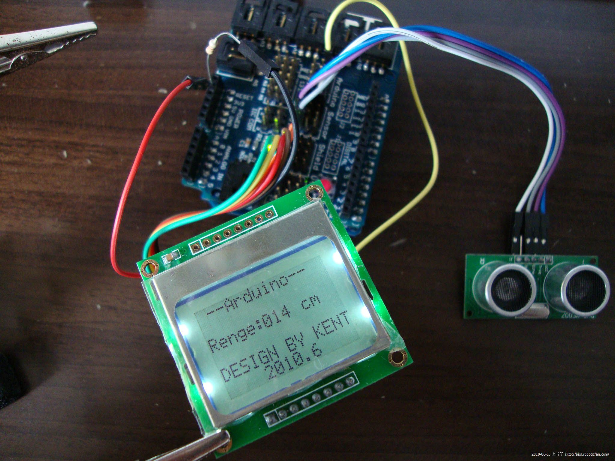

// nokia 5110 arduino驅(qū)動程序(中文,圖形顯示。超聲波測距)
// 版本1.1
// 2010.6
//端口定義
int lcd_ce=2;
int lcd_rst=3;
int sclk=4;
int sdin=5;
int lcd_dc=6;
int inputpin=8;  // 定義超聲波信號接收接口
int outputpin=9; // 定義超聲波信號發(fā)出接口
void setup()
  pinmode(inputpin, input);
  pinmode(outputpin, output);

void loop()
   lcd_init();//初始化液晶
   lcd_clear();//清屏
   lcd_draw_bmp_pixel(30,0,boy_bmp,24,24);        //調(diào)入上面的圖像
   lcd_write_english_string(4,2,"----");          //寫入ascii字符
   lcd_write_english_string(55,2,"----");
   lcd_write_chinese_string(6,3,12,6,0,0);        //寫入中文字符
   lcd_write_english_string(20,5,"arduino");
   delay(5000);
   lcd_clear();                                  //清屏
   lcd_write_english_string(0,0," --arduino-- ");
   lcd_write_english_string(0,2,"renge:");
   lcd_write_english_string(0,4,"design by kent");
   lcd_write_english_string(0,5,"    2010.6    ");
  //以下進(jìn)入超聲波測距
   while(1)
      digitalwrite(outputpin, low); // 使發(fā)出發(fā)出超聲波信號接口低電平2μs
      delaymicroseconds(2);
      digitalwrite(outputpin, high); // 使發(fā)出發(fā)出超聲波信號接口高電平10μs,這里是至少10μs
      delaymicroseconds(10);
      digitalwrite(outputpin, low);    // 保持發(fā)出超聲波信號接口低電平
      int distance = pulsein(inputpin, high);  // 讀出脈沖時間
      distance= distance/58;           // 將脈沖時間轉(zhuǎn)化為距離(單位:厘米)
         if(distance>120)              //如果距離大于120cm
         lcd_write_english_string(35,2,"???"); //在(35, 2)坐標(biāo)上顯示“???”
         else
          lcd_write_english_string(60,2,"cm");     //如果小于120cm
          lcd_set_xy(35, 2);                       //在(35, 2)坐標(biāo)上顯示測出數(shù)值
          lcd_write_char( 0x30+distance00/100); //顯示百位數(shù)
          lcd_write_char( 0x30+distance0/10);   //顯示十位數(shù)
          lcd_write_char( 0x30+distance);       //顯示個位數(shù)
