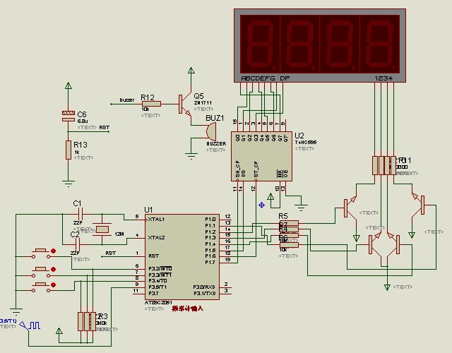

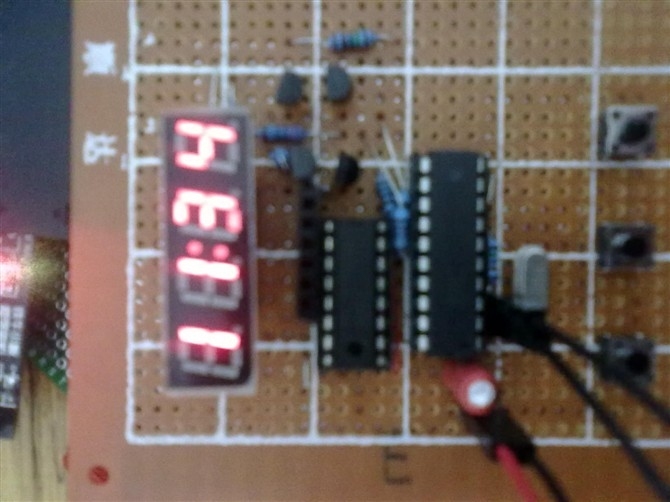

品名:電子時(shí)鐘
功能:秒表,鬧鐘,日歷,計(jì)數(shù)器,頻率計(jì) 時(shí)鐘
作者:阿飛
版本:v1.4
修改:二月調(diào)整bug code unsigned char leab_day[12]={31,28,31,30,31,30,31,31,30,31,30,31};
品名:電子時(shí)鐘
作者:阿飛
版本:v1.4
改成 code unsigned char leab_day[12]={31,29,31,30,31,30,31,31,30,31,30,31};
時(shí)間:2012,8,11
版權(quán)所有:http://www.torrancerestoration.com
#include<reg51.h>
sbit sh=P1^7;
sbit ds=P1^5;
sbit st=P1^6;
sbit led0 = P1^2;
sbit led1 = P1^3;
sbit led2 = P1^4;
sbit led3 = P1^1;
sbit button1 = P3^2;
sbit button2 = P3^3;
sbit button3 = P3^4;
sbit buzzer = P1^0;
sbit RCLK = P3^7;

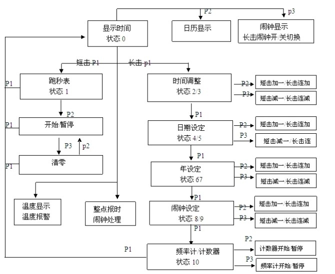

void time_add(void)
switch(time.mode)
case 2: time.min++;if(time.min>59)time.min=0;break;
case 3: time.hou++;if(time.hou>23)time.hou=0;break;
case 4: time.day++;if(time.mon==2&&(time.day>time.February_day))time.day=1;
else if(time.day>leab_day[time.mon-1])time.day=1;break;
case 5: time.mon++;if(time.mon>59)time.mon=0;break;
case 6: time.year[0]++;if(time.year[0]>99)time.year[0]=0;break;
case 7: time.year[1]++;if(time.year[0]>99)time.year[1]=0;break;
case 8: time.AlarmMin++;if(time.AlarmMin>59)time.AlarmMin=0;break;
case 9: time.AlarmHou++;if(time.AlarmHou>59)time.AlarmHou=0;break;
void time_sub(void)
switch(time.mode)
case 2:if(time.min>0) time.min--;else time.min=59;break;
case 3: if(time.hou>0)time.hou--;else time.hou=23;break;
case 4: time.day--;if(time.day<1)
if(time.mon==2)time.day = time.February_day;
else time.day=leab_day[time.mon-1];
} break;
case 5: time.mon--;if(time.mon<1)time.mon=12;break;
case 6: if(time.year[0]>0)time.year[0]--;else time.year[0]=99;break;
case 7: if(time.year[0]>0)time.year[1]--;else time.year[1]=99;break;
case 8: if(time.AlarmMin>0)time.AlarmMin--;else time.AlarmMin=59;break;
case 9: if(time.AlarmHou>0)time.AlarmHou--;else time.AlarmHou=23;break;

按鍵一長(zhǎng)按處理
void isr_button1_proces(void)
if(menu_button1_down_1 ==1)
按鍵一長(zhǎng)按處理
if(button1==0)
time.delaycount--;
if(time.delaycount==0)
time.delaycount = 0;
time.mode = 2;
menu_button1_down_1 = 0;
else
time.mode = 1;
消抖部分 (10~20ms)
if(menu_button1_down==1)
time.ditheringcount--;
if(time.ditheringcount==98)
{ if(button1==0)
if(time.mode==0){menu_button1_down_1=1;time.delaycount = length_whack_ms;}
else if(time.mode==1){time.mode =0;}
else if ((time.mode<10))
time.mode++;
time.flashcount = 0;
menu_button1_down_1=0;
else
time.mode = 0;
flash_flag = 0;
menu_button2_down = 0;
menu_button1_down=0;
按鍵二中斷處理函數(shù)

按鍵二長(zhǎng)按處理
void isr_button2_proces(void)
if(menu_button2_down==1)
if(button2==0)
time.delaycount--;
if(time.delaycount==length_whack_ms-2)//消抖部分 (10~20ms)
if(time.mode==1) start_stopwatch = ~start_stopwatch ;
if(time.mode==10)
cymometer_start_flag =~cymometer_start_flag;
TL1 = 0;
TH1 = 0;
cymometer1_start_flag=0;
time_add();
按鍵二長(zhǎng)按處理
if(button2==0)
time.delaycount--;
if(time.mode==10)
TL1 = 0;
TH1 = 0;
time_add();
time.delaycount = auto_regulator_ms;
button2_length_whack_flag = 1;
// menu_button2_down = 0;
else
button2_length_whack_flag = 0;
if(button2_length_whack_flag)
if(time.mode>1)
time_add();

按鍵三處理函數(shù)
void button3_proces(void)
if((menu_button3_down==0)&&(button3==0))
menu_button3_down = 1;
time.delaycount =length_whack_ms;
按鍵三長(zhǎng)按處理
void isr_button3_proces(void)
if(menu_button3_down==1)
if(button3==0)
time.delaycount--;
if(time.delaycount==length_whack_ms-2) //消抖部分 (10~20ms)
if(time.mode==1) stopwatch_clear_flag = 1;
if(time.mode==10){cymometer1_start_flag=1;time.cymometer_count =cymometer_1s;
TL1 = 0;
TH1 = 0;
start_stopwatch = 0;
time_sub();
button3_length_whack_flag = 1;
else
menu_button3_down = 0;
button3_length_whack_flag = 0;
if(button3_length_whack_flag)
if(time.mode>1)
time_sub();
TR1 =0;
time.cymometer[0]=0;
TH1=0;
time.cymometer[1]=0;
TL1=0;
cymometer1_start_flag =0;

595 驅(qū)動(dòng)
void _74hc595(unsigned char dat)
unsigned char n;
sh=0;
st=0;
for(n=0;n<8;n++)
if(dat&0x80)ds=1;
else ds=0;
sh=1;
dat<<=1;
sh=0;
st=1;

for(n=0 ;n<4;n++)
_74hc595( scanf_dat_temp[n]);
switch(n)
case 0:led0=1;led1=0; led2=0; led3=0;break;
case 1:led0=0;led1=1; led2=0; led3=0;break;
case 2:led0=0;led1=0; led2=1; led3=0;break;
case 3:led0=0;led1=0; led2=0; led3=1;break;
default :led0=0;led1=0; led2=0; led3=0;break;
delay(5);
_74hc595(0xff);
led0 = 0; led1 = 0; led2 = 0; led3 = 0;
delay(1);
加載顯存
void proces_start(void)
unsigned char temp[6];
unsigned int dattemp;
if(time.mode==0) //時(shí)間顯示
scanf_dat[0] = time.hou;
scanf_dat[1] = time.min;
else if(time.mode==1)//秒表顯示
if(time.stopwatch[2]>0)
scanf_dat[0] = time.stopwatch[2];
scanf_dat[1] = time.stopwatch[1];
else
scanf_dat[0] = time.stopwatch[1];
scanf_dat[1] = time.stopwatch[0];
else if(time.mode<4)//
else if(time.mode<6)
scanf_dat[0] = time.mon;
scanf_dat[1] = time.day;
else if(time.mode<8)
scanf_dat[0] = time.year[1];
scanf_dat[1] = time.year[0];
else if(time.mode<10)
scanf_dat[0] = time.AlarmHou;
scanf_dat[1] = time.AlarmMin;
else
dattemp = time.cymometer[1];
dattemp = dattemp<<8;
dattemp+= time.cymometer[0];
temp[1] = dattemp%10000/100;
temp[0] = dattemp%100;
scanf_dat[0] = temp[1];
scanf_dat[1] = temp[0];
if((time.AlarmHou==time.hou)&&(time.AlarmMin==time.min)&&(Alarm_on_off==1))
buzzer = 1;
else buzzer=0;
