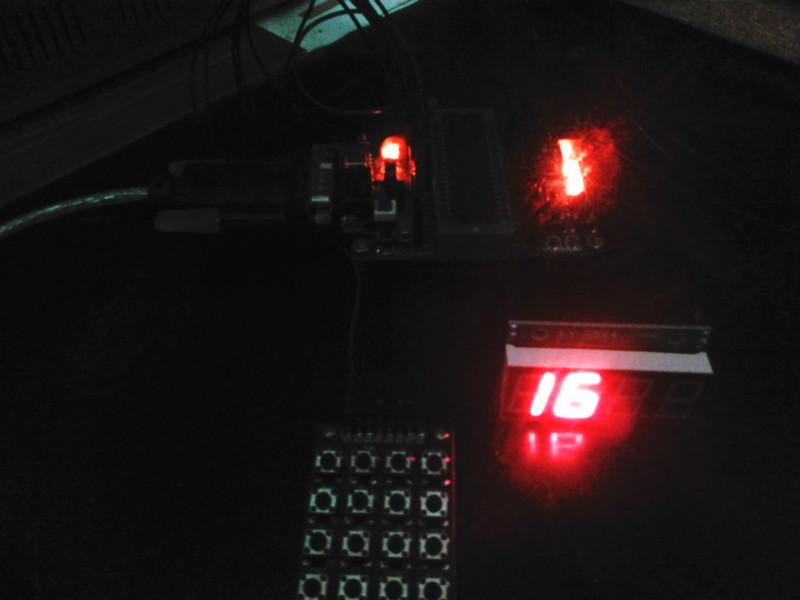

#include <reg52.h>
code unsigned char table[]={0xc0,0xf9,0xa4,0xb0,0x99,0x92,0x82,0xf8,0x80,0x90};    //表:共陽數(shù)碼管 0-9
#define DAT P1     /按鍵值數(shù)據(jù)口
sbit key0=P1^0;
sbit key1=P1^1;
sbit key2=P1^2;
sbit key3=P1^3;
sbit key4=P1^4;
sbit key5=P1^5;
sbit key6=P1^6;
sbit key7=P1^7;
#define DATA_number P2   //數(shù)碼管數(shù)據(jù)口
//-------數(shù)碼管位選------
sbit H1=P2^0;
sbit H2=P2^1;
sbit H3=P2^2;
sbit H4=P2^3;
sbit DA=P2^4;     //數(shù)碼管驅(qū)動(dòng)數(shù)據(jù)
sbit SC=P2^5;     //數(shù)碼管驅(qū)動(dòng)數(shù)據(jù)移動(dòng)電平
sbit ST=P2^6;     //數(shù)碼管驅(qū)動(dòng)鎖存輸出電平
//-----------按鍵值返回函數(shù)------------------------
unsigned int key_scan(void)
 unsigned int temp;
 bit find=0;
 DAT=0xf0;
    if((DAT&0xf0)!=0xf0)
     find=1;
 if(key4==0){temp=3;}
 else if(key5==0){temp=2;}
 else if(key6==0){temp=1;}
 else if(key7==0){temp=0;}
 DAT=0x0f;
 if(key3==0){temp+=12;}
 else if(key2==0){temp+=8;}
 else if(key1==0){temp+=4;}
 else if(key0==0){temp+=0;}
if(find==1){return temp; }
else return 16;
//----------------數(shù)碼管驅(qū)動(dòng)輸出數(shù)字函數(shù)--------------
void output(unsigned char cnt)
 unsigned char i;
 for(i=0;i<8;i++)
  SC=0;
  DA=cnt&0x80;
  SC=1;
  cnt<<=1;
//-----------主函數(shù)顯示按鍵值-------------
void main(void)
 unsigned int kk;
 while(1)
   kk=key_scan();
   output(table[kk/10]);
   DATA_number=0x0f;   //關(guān)閉顯示,位切換準(zhǔn)備
   ST=0;                         /鎖存準(zhǔn)備
   ST=1;                        //數(shù)據(jù)鎖存到輸出
   H1=0;                          //打開顯示位0
   output(table[kk%10]);
   DATA_number=0x0f;
   ST=0;
   ST=1;
   H2=0;
//---------------------數(shù)碼管驅(qū)動(dòng)芯片采用---74HC595----
