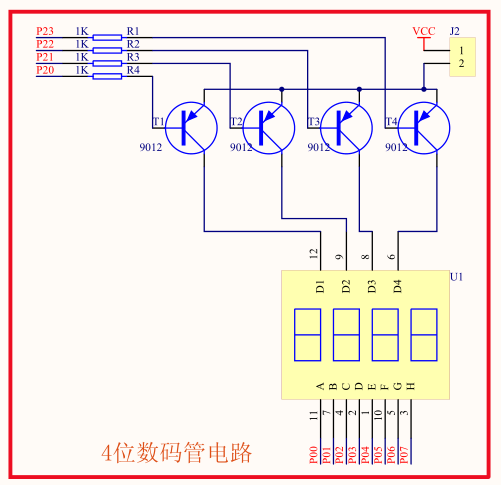

#include <reg52.h>
#define uchar unsigned char
sbit P2_0 = P2^0;
sbit P2_1 = P2^1;
sbit P2_2 = P2^2;
sbit P2_3 = P2^3;
static unsigned char second,minute,hour;
unsigned int tcount;
unsigned char m;
uchar code table[]={0xc0,0xf9,0xa4,0xb0,0x99,0x92,0x82,
                        0xf8,0x80,0x90};
void delay(uchar i)
  uchar j,k;
  for(j=i;j>0;j--)
    for(k=125;k>0;k--);
void display()
   P0=table[minute/10];
   P2_0 = 0;
   delay(5);
   P2_0 = 1;
   P0=(table[minute%10]& 0x7f);
   P2_1 = 0;
   delay(5);
   P2_1 = 1;
   P0=table[second/10];
   P2_2 = 0;
   delay(5);
   P2_2 = 1;
    P0=table[second%10];
   P2_3 = 0;
   delay(5);
   P2_3 = 1;
/*演示主程序*/
void main(void)
    unsigned int  a;
    TMOD=0x02;
    TH0=0x06;
    TL0=0x06;
    TR0=1;
    ET0=1;
    EA=1;
 while(1)
   for(a=100;a>0;a--)
     display();
