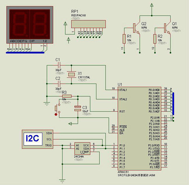

程序功能:統(tǒng)計(jì)單片機(jī)的開機(jī)次數(shù)。
#include<reg52.h>
#include<intrins.h>
#define uint unsigned int
#define uchar unsigned char
sbit sda=P1^1;
sbit scl=P1^0;
uchar temp=0;
uchar data_h,data_l;
uchar state;
const uchar tab[]={0xc0,0xf9,0xa4,0xb0,0x99,0x92,0x82,0xf8,0x80,0x90};

匯編程序:
;24c02的開機(jī)計(jì)數(shù)器,系統(tǒng)復(fù)位一次數(shù)碼管加1
SDA24 EQU P1.1
SCLK24 EQU P1.0
SCLK24 EQU P1.0
ORG 0000H
AJMP MAIN
ORG 0030H
MAIN:
CLR P3.7 ;打開寫保護(hù)
MOV DPTR,#TAB
