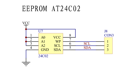

主:STC89C54
從: AT24C02
                                        電路圖

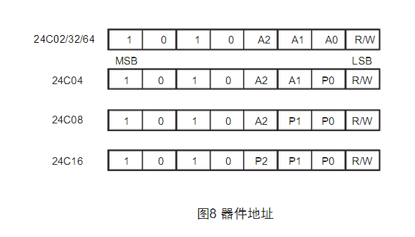

#define addr_x 0xae // 寫(xiě)
#define addr_d 0xaf        //      讀

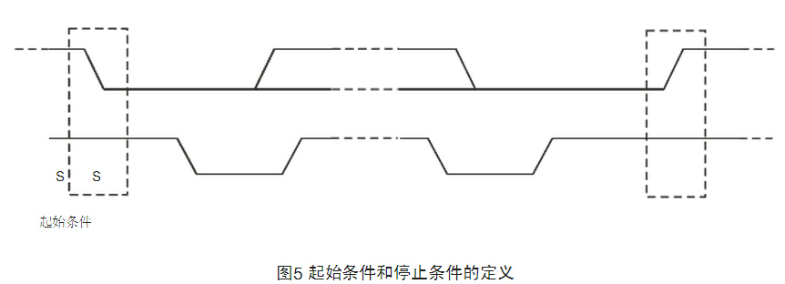

void i2_qs() //起始信號(hào)
sda = 1; //拉高數(shù)據(jù)
scl = 1; //拉高時(shí)鐘
delay(); //延時(shí)大于 4μs
sda = 0; //拉低數(shù)據(jù)產(chǎn)生起始信號(hào)(下降沿)
scl = 0; //拉低時(shí)鐘
void i2_tz() //停止信號(hào)
sda = 1; //拉高時(shí)鐘產(chǎn)生結(jié)束信號(hào)(上升沿)

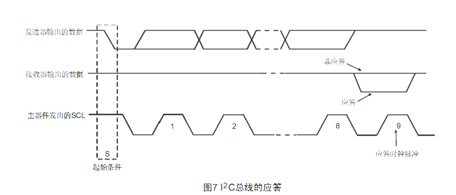

void i2_ack(bit _ack) //入口產(chǎn)生 0 ack 1 nak
sda = _ack; //ack或者nak

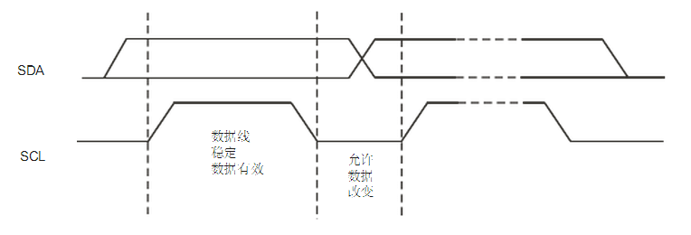

void i2_fs(uchar Data) //發(fā)送8位數(shù)據(jù)
uchar i;
for(i=0;i<8;i++) //8位計(jì)數(shù)
Data <<= 1; //把最高位移送到進(jìn)制標(biāo)志位中(CY)
sda = CY; //把進(jìn)制位中的數(shù)據(jù)賦值給數(shù)據(jù)線
//這里
//下面代碼是接收ACK的代碼
delay();//延時(shí)大于 4μs
sda = 1; //拉高數(shù)據(jù)準(zhǔn)備接收ACK
scl = 1; //拉高時(shí)鐘產(chǎn)生穩(wěn)定的有效的數(shù)據(jù)(相對(duì)的)
if(sda==1) //確認(rèn)接收的是ACK還是NAK
ack = 0;//ack
else
ack = 1;//nak
delay(); //延時(shí)大于 4us

i2_fs(addr_x); //設(shè)備地址+寫(xiě)信號(hào)

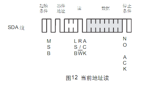

uchar i2_sj_d(uchar addr) //讀取數(shù)據(jù)(參數(shù) 寄存器地址)
uchar Data;
i2_qs(); //起始信號(hào)
i2_fs(addr); //寄存器內(nèi)部地址
i2_fs(addr_d); //設(shè)備地址+讀信號(hào)
Data = i2_js(); //讀取數(shù)據(jù)
i2_ack(0); //ACK應(yīng)答
i2_tz(); //停止信號(hào)
return Data; //返回讀取的數(shù)據(jù)
