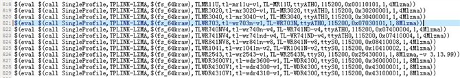

2imagebuilder下面修改(如果用imagebuilder 來編譯固件,需修改此處!)
/target/linux/ar71xx/image/Makefile
703n最后的4Mlzma改成8Mlzma!
