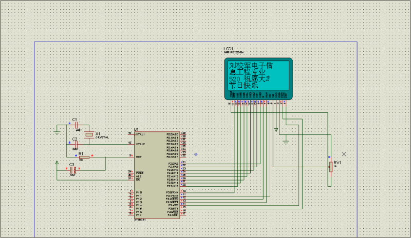

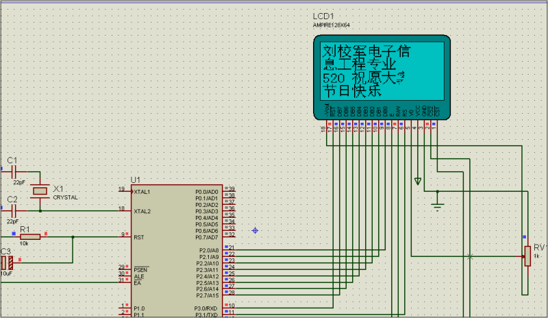

基于12864液晶的程序代碼顯示本人姓名及專業(yè)
作者:huqin   來源:本站原創(chuàng)   點(diǎn)擊數(shù):  更新時(shí)間:2014年04月04日   【字體:

void display()
cs1=0; //左半屏 cs1=0 cs2=1
cs2=1;
hanzi(0,0,liu);
hanzi(0,16,xiao);
hanzi(0,32,jun);
hanzi(0,48,dian);
cs1=1; //右半屏 cs1=1 cs2=0
cs2=0;
hanzi(0,0,zi);
hanzi(0,16,xin);
//hanzi(0,32,kongge); // 如果清屏?xí)r加上cs1=0 cs2=0則可以不用,否則要加上
//hanzi(0,48,kongge);
cs1=0;
cs2=1;
hanzi(2,0,xi);
hanzi(2,16,gong);
hanzi(2,32,cheng);
hanzi(2,48,zhuan);
cs1=1;
cs2=0;
hanzi(2,0,ye);
//hanzi(2,16,wang);
//hanzi(2,32,kongge);
//hanzi(2,48,kongge);
cs1=0;
cs2=1;
shuzi(4,0,wu);
shuzi(4,8,er);
shuzi(4,16,ling);
//hanzi(4,32,zhu);
hanzi(4,32,zhu);
hanzi(4,48,yuan);
cs1=1;
cs2=0;
hanzi(4,0,da);
shuzi(4,16,jia);
//hanzi(4,24,jia);
//hanzi(4,40,kongge);
shuzi(4,56,kong);
cs1=0;
cs2=1;
//hanzi(6,0,jia);
hanzi(6,0,jie);
hanzi(6,16,ri);
hanzi(6,32,kuai);
hanzi(6,48,le);
cs1=1;
cs2=0;
//hanzi(6,0,kongge);
//hanzi(6,16,kongge);
//hanzi(6,32,kongge);
//hanzi(6,48,kongge);
void main()
init();
clearlcd();
while(1)
display();
