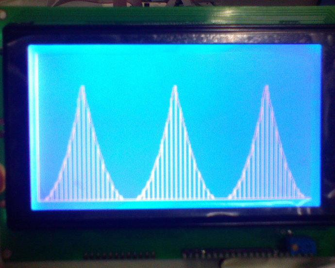

當(dāng)前位置:單片機(jī)教程網(wǎng) >> MCU設(shè)計實例 >> 瀏覽文章
拉格朗日插值法曲線擬合--頻譜圖
作者:浪子   來源:浪子   點擊數(shù):  更新時間:2014年06月10日   【字體:
#include<AT89X52.H>
#include<math.h>
#define uchar unsigned char
#define uint  unsigned int
#define L240DAT P1
#define N 60
sbit L240CD=P3^2;
sbit L240RD=P3^3;
sbit L240WR=P3^4;
sbit L240BC=P1^0;
sbit L240BD=P1^1;
sbit RST=P3^5;
uchar code dat0[61]={16,16,28,50,68,80,92,100,92,80,68,50,28,15,28,46,60,46,28,17,15,28,34,28,15,20,15,16,28,50,68,
                     80,92,100,92,80,68,50,28,15,28,46,60,46,28,17,15,28,34,28,15,20,15,16,18,20,27,38,49,62,80};
uchar  dat1[5];
 void Delay(int x)
{int k,m;
   { for(m=0;m<x;m++)
    for(k=0;k<25;k++);
void LCD_NOP(void)
    unsigned    char i;
   for(i=0;i<5;i++);
 uchar l240rc(void)
    uchar chk;
    L240DAT=0xff;
    L240RD=1;
    L240CD=1;
    L240RD=0;
    chk=L240DAT;
    L240RD=1;
    return chk;
void l240wcl(uchar dat1,uchar dat2,uchar com)
    while((l240rc()&0x03)!=0x03);
    L240CD=0;
    L240DAT=dat1;
    L240WR=0;
 LCD_NOP();
    L240WR=1;
    L240CD=0;
    L240DAT=dat2;
    L240WR=0;
 LCD_NOP();
    L240WR=1;
    L240CD=1;
    L240DAT=com;
    L240WR=0;
 LCD_NOP();
    L240WR=1;
void l240wc(uchar dat)
    L240CD=1;
    L240DAT=dat;
    L240WR=0;
 LCD_NOP();
    L240WR=1;
void l240wd(uchar dat)
    L240CD=0;
    L240DAT=dat;
    L240WR=0;
 LCD_NOP();
    L240WR=1;
void l240wdz(uchar dat)       //進(jìn)入自動讀寫模式時判忙函數(shù)
    while((l240rc()&0x08)!=0x08);
    L240CD=0;
    L240DAT=dat;
    L240WR=0;
 LCD_NOP();
    L240WR=1;
void intl240(void)
    L240CD=1;
    L240WR=1;
    L240RD=1;
    L240BC=1;
    L240BD=1;
    l240wcl(0x00,0x00,0x40);//初始化
    l240wcl(0x20,0x00,0x41);
    l240wcl(0x00,0x08,0x42);
    l240wcl(0x20,0x00,0x43);
    l240wc(0xa7);
    l240wc(0x81);
void writepoint(uchar x,uchar y,uchar show)
  uchar x_pt,y_pt;
  uint address;
  x_pt=x;
  if(show==1)
   y_pt=y+128;
  address=(y_pt&0x7f)*32+x_pt/8+0x0800;  //計算顯示存儲器地址
  l240wcl((uchar)(address),(uchar)(address>>8),0x24);  //設(shè)置顯示存儲器地址
  x_pt=(~(x_pt%8))&0x07;
  y_pt=((y_pt&0x80)>>4)|0xf0;
  l240wc(x_pt|y_pt);  //寫入數(shù)據(jù)
 //設(shè)置地址
void glcd_set_address(unsigned int addr){
 l240wd((unsigned char)(addr));
 l240wd(addr>>8);
 l240wc(0x24);  //0x24為設(shè)定地址命令
void clear_graph(void)         // 圖形清屏
 int i;
 glcd_set_address(0x800);     // 設(shè)置地址為圖形區(qū)基地址
 for (i=0;i<3840*2;i++)     // 必須為3840
  l240wd(0);   // 寫入數(shù)據(jù)0x00 則不顯示
  l240wc(0xc0);    // 0xc0為數(shù)據(jù)寫入、增加指針 命令
void clear_c(void)          //清文本
   { int m;
    l240wcl(0x00,0x00,0x24);
    l240wc(0xb0);
    for(m=0;m<0x0800;m++)
        l240wdz(0x00);
    l240wc(0xb2);
   void line(int x1, int y1, int x2, int y2, unsigned char show)
 int dy ;
 int dx ;
 int stepx, stepy, fraction;
 dy = y2 - y1;
 dx = x2 - x1;
        if (dy < 0)
  dy = -dy;
  stepy = -1;
 else
  stepy = 1;
 if (dx < 0)
  dx = -dx;
  stepx = -1;
 else
  stepx = 1;
 dy <<= 1;
 dx <<= 1;
        if((x2<240&x1>0)|(x1<240&x2>0))
 {writepoint(x1,y1,show);}
 if (dx > dy)
  fraction = dy - (dx >> 1);
  while (x1 != x2)
   if (fraction >= 0)
    y1 += stepy;
    fraction -= dx;
   x1 += stepx;
   fraction += dy;
   {writepoint(x1,y1,show); }
 else
  fraction = dx - (dy >> 1);
  while (y1 != y2)
   if (fraction >= 0)
    x1 += stepx;
    fraction -= dy;
   y1 += stepy;
   fraction += dx;
       { writepoint(x1,y1,show); }
uchar nihe(int y0,int y1,int y2,int i)
  {  float y;
     if (i==1)
     y=21*y0/32+y1*7/16-y2*3/32;
     else if(i==2)
     y=-y0/2+y1*4/3+y2/6;
     else y=-y0/3+y1+y2/3;
     return(y);
void quxian(void)
 {  int i,j;
    uchar a;
    signed char dy;
    clear_graph();
    line(1,0,1,127,1);
    line(1,127,239,127,1);
    for(i=0;i<N;i++)
   {dat1[0]=dat0[i];
    dat1[1]=nihe(dat0[i],dat0[i+1],dat0[i+2],1);
    dat1[2]=nihe(dat1[0],dat1[1],dat0[i+1],2);
    dat1[3]=nihe(dat1[1],dat1[2],dat0[i+1],3);
    dat1[4]=dat0[i+1];
    for(j=0;j<4;j++)
      { dy=dat1[j]-dat1[j+1];
      line(4*i,127,4*i,127-dat0[i],1);
     if(dy>=0)
        {for(a=0;a<dy;a++)             //下降
           {writepoint(4*i+j,(128-(dat1[j]-a)),1);}
           writepoint(4*i+j+1,(128-(dat1[j]-a)),1);
     else
       {for(a=0;a<(-(dy));a++)      //上升
       {writepoint(4*i+j,(128-(dat1[j]+a)),1);}
main()
{       RST=0;
  Delay(10);
 RST=1;
 Delay(50);
  intl240();  ///初始化必有
        clear_c();
        clear_graph();
        l240wc(0x9c);
 while(1){
        quxian();
