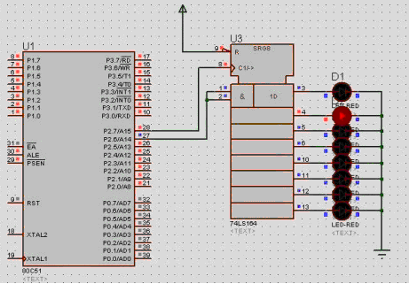

51單片機驅(qū)動74ls164跑馬燈,好處是只用了2個端口即可實現(xiàn),電路如下圖所示:
#include<reg51.h>
#include<intrins.h>
#define uint unsigned int
#define uchar unsigned char
sbit dat=P2^6;
sbit clk=P2^7;
uchar ii;
uchar code seg7code[]={0x01,0x02,0x04,0x08,0x10,0x20,0x40,0x80,0x00,0xff};//0-9,-,全滅
void sendbyte(uchar seg)
 uchar num,c;
 num=seg7code[seg];
 for(c=0;c<8;c++)
 dat=num&0x80;
 num=_crol_(num,1);
 clk=0;
 clk=1;
void delayms(int ms)
 uchar mi,mj;
 for(;ms>0;ms--)
  for(mi=6;mi>0;mi--)
   for(mj=82;mj>0;mj--);
void main()
 for(ii=0;ii<10;ii++)
 sendbyte(ii);
 delayms(200);
