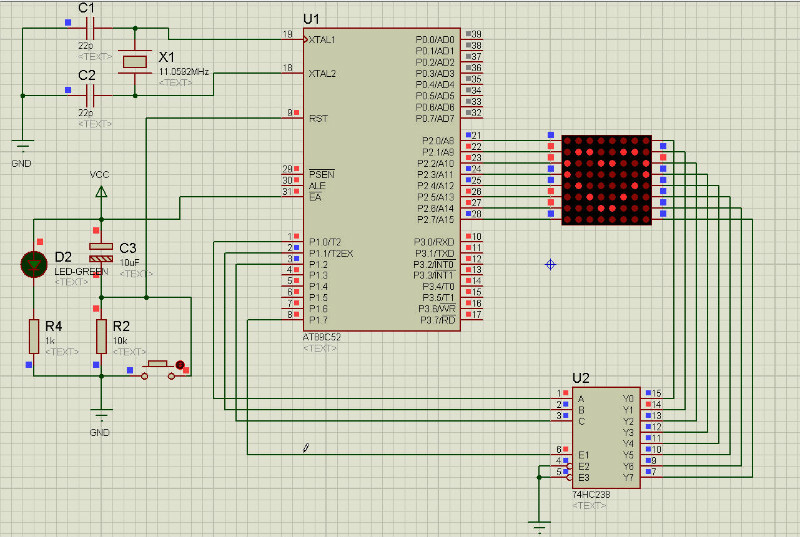

寫不下去了  直接上代碼
#include <reg52.h>
typedef unsigned char uint8;
typedef unsigned int uint16;
sbit acon=P1^0;      //38譯碼器
sbit bcon=P1^1;
sbit ccon=P1^2;
sbit en=P1^7;         //譯碼器使能
uint8 j=0,k=0;
uint16 i=0;
code uint8 ledcode[]={ 0xFF,0xFF,0xFF,0xFF,0xFF,0xFF,0xFF,0xFF,  //
  0xFF,0xC3,0xE7,0xE7,0xE7,0xE7,0xC3,0xFF,  //    I
  0xFF,0x99,0x66,0x7E,0xBD,0xDB,0xE7,0xFF,  //   心
  0xFF,0x99,0x99,0x99,0x99,0x99,0xC3,0xFF,  //   U
  0xFF,0xFF,0xFF,0xFF,0xFF,0xFF,0xFF,0xFF };  //     哄老婆用
void timer1_init()
TMOD|=0x10;
TMOD&=0xef;
TH1=0xfc; //1ms
TL1=0x66;
TR1=1;        //定時(shí)器1開(kāi)啟
void inter_init()
ET1=1;              //定時(shí)器1中斷開(kāi)啟
EA=1;               //總中斷開(kāi)啟
void frush()
switch(j)
case 0:acon=0;bcon=0;ccon=0;break;                               //掃描LED點(diǎn)陣
case 1:acon=1;bcon=0;ccon=0;break;
case 2:acon=0;bcon=1;ccon=0;break;
case 3:acon=1;bcon=1;ccon=0;break;
case 4:acon=0;bcon=0;ccon=1;break;
case 5:acon=1;bcon=0;ccon=1;break;
case 6:acon=0;bcon=1;ccon=1;break;
case 7:acon=1;bcon=1;ccon=1;break;
P2=ledcode[k+j];                  //逐行輸出
if(j==7)j=0;
j++;
main()
en=1;
P2=0xff;
timer1_init();
inter_init();
while(1);
void timer1_interrupt() interrupt 3
TH1=0xfc;
TL1=0x66;
i++;
frush();
if(i==500)
i=0;
if(k==32)k=0;
k++;
仿真圖:
