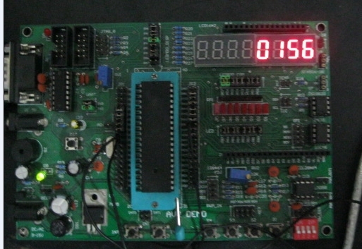

//----------------------------------------AVR代碼------------------------
#include <iom16.h>
#include <intrinsics.h>
#define uchar unsigned char
#define uint unsigned int
uchar seg[10]={0x3f,0x06,0x5b, //共陰極數(shù)碼管0~9的字形碼
0x4f,0x66,0x6d,0x7d,0x07,0x7f,0x6f};
uchar tab[4]={0xfe,0xfd,0xfb,0xf7};//4位共陰極數(shù)碼管的位選碼
#define UDRE 5
#define RXC 7
uchar datt;  //接受到的數(shù)據(jù)比較變量
uchar adc_val;  //模擬量轉(zhuǎn)換值
void delay(uint k)
 while(k--);
void port_init()
PORTA=0x7f;    // 通道7作為模擬量輸入
DDRA=0x7f;
PORTB=0xff;
DDRB=0xff;
PORTC=0xff;
DDRC=0xff;
PORTD=0xff;
DDRD=0xff;
void adc_init()  //模擬量初始化
  ADCSRA=0xe3;
  ADMUX=0xc7;
uint adc_vert()
 uint temp1,temp2;
 temp1=(uint)ADCL;
 temp2=(uint)ADCH;
 temp2=(temp2<<8)+temp1;
 return temp2;
void time0_init()  //定時器0初始化
  TCNT0=0x83;
  TCCR0=0x03;
  TIMSK=0x01;  //定時器0溢出中斷
#pragma vector = 0x24
__interrupt void time0_vef()
 static uchar i;
  TCNT0=0x83;
  i++;
  if(i>3)i=0;
  switch(i)
  case 0:PORTA=seg[adc_val%10];PORTC=tab[0];break;
  case 1:PORTA=seg[adc_val%100/10];PORTC=tab[1];break;
  case 2:PORTA=seg[adc_val%1000/100];PORTC=tab[2];break;
  case 3:PORTA=seg[adc_val/1000];PORTC=tab[3];break;
  default:break;
void uart_init()
  UCSRB=0x00;     //串口不使能
  UCSRA=0x02;    //串口倍速模式
  UCSRC=0x06;    //數(shù)據(jù)長度設置為8位
  UBRRL=0x67;    //串口設置為9600波特率
  UBRRH=0x00;
  UCSRB=0x98;    //串口接受和發(fā)送使能,接受中斷使能
void uart_send(uchar k)  //串口發(fā)送函數(shù)
  while(!(UCSRA&(1<<UDRE)));
        UDR=k;
uchar uart_receive()
 while(!(UCSRA&(1<<RXC))); //接受結(jié)束讀出數(shù)據(jù)
 return UDR;
void send_number(uint k)
uart_send((uchar)(k>>8));
uart_send((uchar)(k));
#pragma vector = 0x2c
__interrupt void uart_rxc()
 datt=UDR;
 if(datt=='a')PORTB=0xff;
 else PORTB=0x00;
void main()
 port_init();
 uart_init();
 time0_init();
 adc_init();
 SREG=0x80;
 while(1)
  adc_val=adc_vert();
  delay(50000);
  delay(50000);
  delay(50000);
  send_number(adc_val);

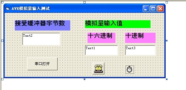

//----------------------VB代碼----------------------------
Private Sub Command1_Click()
MSComm1.CommPort = 4
MSComm1.PortOpen = True
MSComm1.InputMode = comInputModeBinary
MSComm1.InputLen = 0
Private Sub MSComm1_OnComm()
Dim bytereceive() As Byte  '定義字節(jié)數(shù)組
Dim strbuf As String     '定義字符串變量
Select Case MSComm1.CommEvent
Case comEvReceive   '接受事件發(fā)生
Text2 = MSComm1.InBufferCount   '顯示接受緩沖區(qū)字節(jié)數(shù)
strbuf = MSComm1.Input   '從輸入緩沖區(qū)讀取字符
bytereceive() = strbuf   '字符串賦值給字符數(shù)組,低字節(jié)在前,高字節(jié)在后
Dim i As Integer
For i = 0 To UBound(bytereceive)  'UBound返回數(shù)組可用的最大長度
If Len(Hex(bytereceive(i))) = 1 Then
strdata = strdata & "0" & Hex(bytereceive(i))
Else
strdata = strdata & Hex(bytereceive(i))
End If
Next
Text1.Text = strdata   '十六進制顯示
Text3.Text = Val("&H" & strdata)  '十進制顯示
strdata = ""
End Select
End Sub
