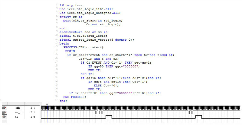

  鎖定一段時(shí)間的及時(shí)程序:
      library ieee;
Use ieee.std_logic_1164.all;
Use ieee.std_logic_unsigned.all;
entity ss is
  port(clk,cr_start:in std_logic;
              Co:out std_logic);
end;
architecture sec of ss is
signal t,c1,c2:std_logic;
signal qq:std_logic_vector(5 downto 0);
begin
  PROCESS(CLK,cr_start)
   BEGIN
    if cr_start'event and cr_start='1' then t<=not t;end if;
          C1<=CLK and t and c2;
           IF C1'EVENT AND C1='1' THEN qq<=qq+1;
               IF qq=50 THEN qq<="000000";
               END IF;
           END IF;
           if qq<45 then c2<='1';else c2<='0';end if;
               IF qq>5 and qq<16 THEN Co<='1';
                  ELSE Co<='0';
               END IF;
     if cr_start='0' then qq<="000000";t<='0';end if;
  END PROCESS;
end;
下面是波形仿真:按一下開(kāi)始鍵可以從新開(kāi)始這段計(jì)時(shí)。

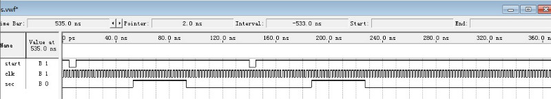

------------------產(chǎn)生1秒種的計(jì)數(shù)時(shí)間------
library ieee;
use ieee.std_logic_1164.all;
use ieee.std_logic_unsigned.all;
entity sec_1s is
port( clk,start:in std_logic;
            sec:out std_logic);
end;
architecture ss of sec_1s is
signal q:std_logic_vector(5 downto 0);
signal c0,c1,c2:std_logic;
begin
process(clk,start)
   begin
     if start'event and start='1' then c0<=not c0;end if;
     c2<=clk and c0 and (not c1);
     if c2'event and c2='1' then q<=q+1;
         if q>51 then c1<='1';else c1<='0';end if;
         if q>20 and q<41 then sec<='1';else sec<='0';end if;
     end if;
     if start='0' then c0<='0';q<="000000";c1<='0';end if;
end process;
end;

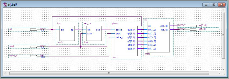

---------------------------原理圖完成頻率計(jì)整體測(cè)試-----------------------------
