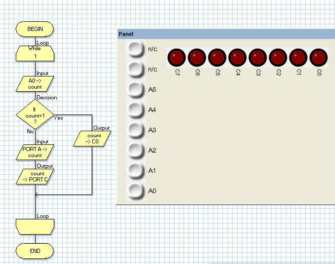

程序介紹:簡單的按鍵按下,相應(yīng)的燈亮,按鍵彈起,燈滅。只有一個(gè)按鍵哦,相應(yīng)的也只是一個(gè)燈亮。

//Loop: While 1
while (1)
//Input
//Input: A0 -> count
trisa = trisa | 0x01;
FCV_COUNT = ((porta & 0x01) == 0x01);
//Decision
//Decision: count=1?
if (FCV_COUNT==1)
//Output
//Output: count -> C0
trisc = trisc & 0xfe;
if (FCV_COUNT)
portc = (portc & 0xfe) | 0x01;
else
portc = portc & 0xfe;
} else {
//Input
//Input: PORT A -> count
trisa = trisa | 0xff;
FCV_COUNT = porta;
//Output
//Output: count -> PORT C
trisc = 0x00;
portc = FCV_COUNT;
mainendloop: goto mainendloop;
