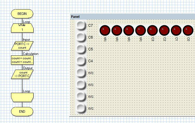

程序介紹:使用同一個(gè)IO口進(jìn)行設(shè)置,高字節(jié)為按鍵,低字節(jié)為燈,流程中嵌入關(guān)系式變化:
 FCV_COUNT = FCV_COUNT>>4;
FCV_COUNT = FCV_COUNT & 0x0f;

  //Input: PORT C -> count
  trisc = trisc | 0xff;
  FCV_COUNT = portc;
  //Calculation
  //Calculation:
  //  count = count>>4
  //  count = count AND 0x0f
  //Output
  //Output: count -> PORT C
  trisc = 0x00;
  portc = FCV_COUNT;
