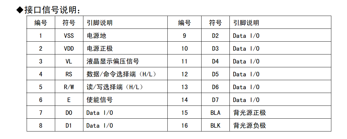

sbit lcdwrite=P2^5;
sbit lcddatecommand=P2^6;
sbit lcde=P2^7;

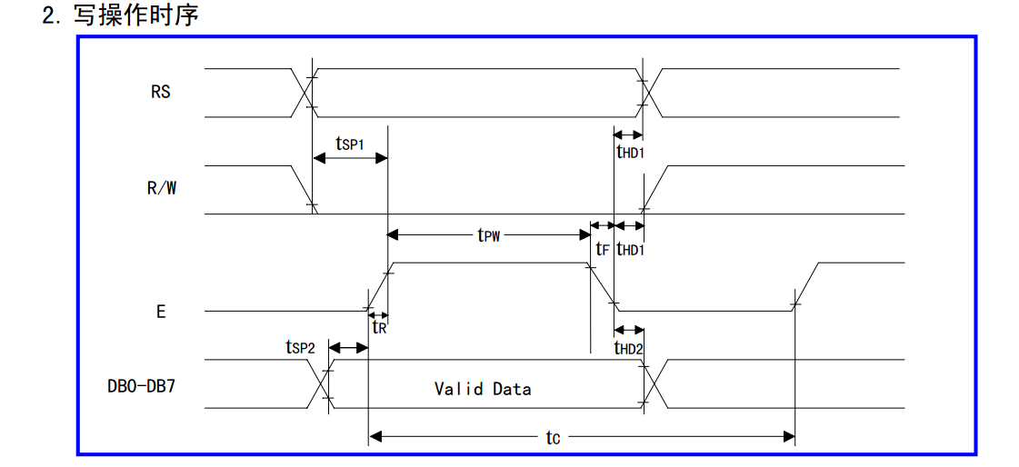

void write_command(uchar command)//寫指令
lcddatecommand=0;
lcdwrite=0;
P0=command;
delay(1);
lcde=1;
delay(1);
lcde=0;
void write_date(uchar date)//寫數(shù)據(jù)
lcddatecommand=1;
lcdwrite=0;
P0=date;
delay(5);
lcde=1;
delay(5);
lcde=0;
void init()
lcde=0;

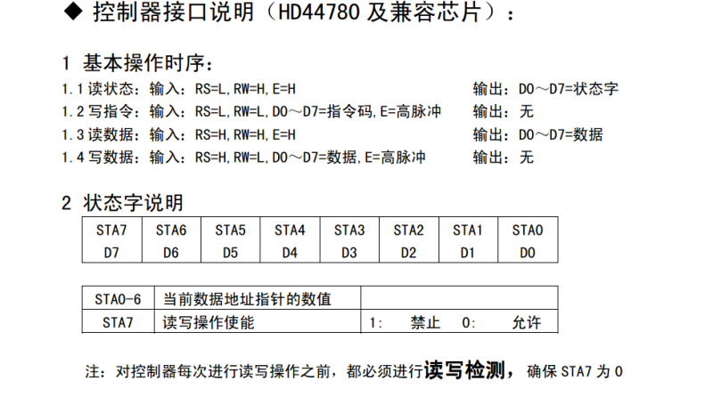

write_command(0x38);//設(shè)置16*2顯示,5*7點(diǎn)陣,8位數(shù)據(jù)接口
write_command(0x0c);//設(shè)置開(kāi)顯示,不顯示光標(biāo)
write_command(0x06);// 寫一個(gè)字符后地址指針加1
write_command(0x01);//顯示清0,數(shù)據(jù)指針清0

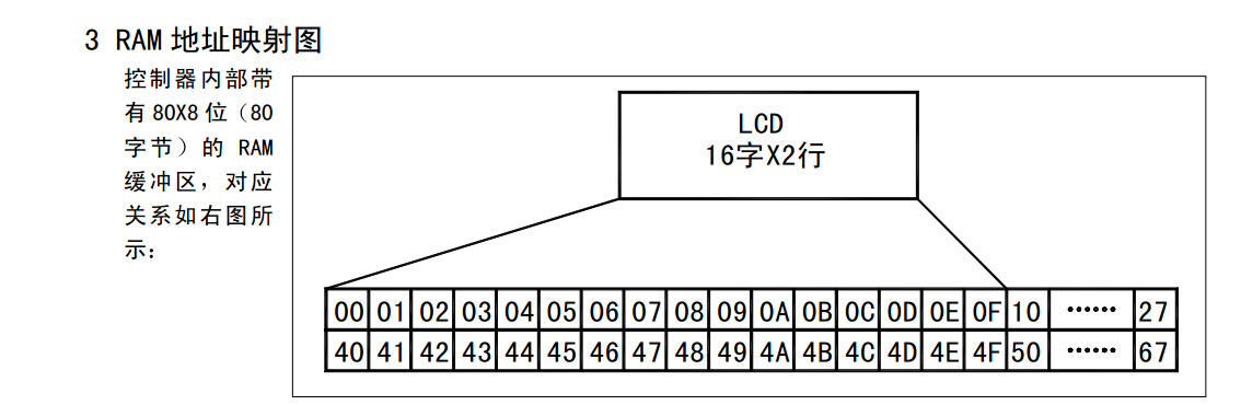

write_command(0x80+0x10);
for(i=0;i<7;i++)
write_date(LA_Mask[i]);
delay(1);
write_command(0x80+0x50);
for(i=0;i<8;i++)
write_date(AT_Eagle[i]);
delay(1);
