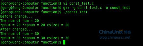

    #include <iostream>
    #include <string>
    #include <vector>
    using namespace std;
    int main()
            int num = 20;
            const int array_size = 10;
            int *pnum = &num;
            const int * cpnum = &num;
            /*const int *指針可以采用int *指針直接初始化*/
            const int *csize1 = pnum;
            /*但是int * 指針不能采用const int *制作初始化*/
            //int *psize = &array_size;
            /*const類型數(shù)據(jù)只能采用指向const的指針來指向*/
            const int *csize = &array_size;
            cout << "Before change..." << endl;
            cout << "The num of num = " << num << endl;
            cout << "*pnum = " << *pnum << " "
                    << "*cpnum = " << *cpnum << " "
                    << "csize1 = " << *csize1 << endl;
            num = 30;
            cout << "After changed..." << endl;
            return 0;
    從上面的結(jié)果我們可以知道指向const的指針可以采用非const變量的地址進(jìn)行初始化或者賦值操作,同時也可以采用指向非const指針直接初始化指向const的指針。同時指向const的指針不能賦值給指向非const的指針,會出現(xiàn)const int *不能轉(zhuǎn)換到int *的問題。

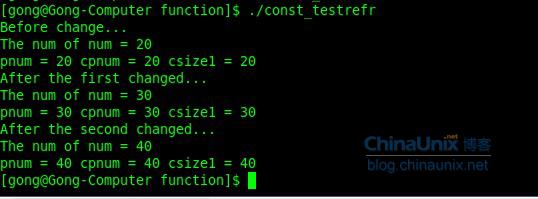

    #include <iostream>
    #include <string>
    #include <vector>
    int main()
            int num = 20;
            int &pnum = num;
            const int &cpnum = num;
            /*采用引用直接初始化const類型的引用*/
            const int &csize1 = pnum;
            /*const的變量不能采用非const的引用*/
            //int &psize = array_size;
            const int &csize = array_size;
            cout << "pnum = " << pnum << " "
                    << "cpnum = " << cpnum << " "
                    << "csize1 = " << csize1 << endl;
            num = 30;
            cout << "After the first changed..." << endl;
            /*通過引用修改變量的值*/
            pnum = 40;
            cout << "After the second changed..." << endl;
            /*不能采用const的引用修改對象,
            *這與指向const的指針特性的相似處*/
            csize1 = 50;
            double dnum = 10.1;
            /*非const的引用只能綁定相同類型的對象*/
            //int &dname = dnum;
            *const引用可以綁定不同類型的對象,
            *因此const引用就能更加方便的作為函數(shù)的形參
            const int &dothername = dnum;
            return 0;
上面的實驗結(jié)果基本上符合分析的結(jié)論。
