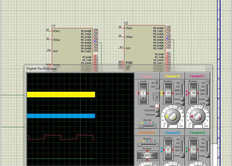

單片機(jī)產(chǎn)生脈寬300MS周期600MS方波(由外部計數(shù)T0接收脈寬1.5MS周期3MS方波)
作者:huqin   來源:本站原創(chuàng)   點擊數(shù):  更新時間:2014年04月08日   【字體:
采用51單片機(jī)芯片下面是匯編語言源代碼:
   org 0000h
       sjmp main
       org 000bh
       SJMP ZCXC;
MAIN:MOV TMOD,#01010101B
     MOV TL0,#9CH;
     MOV TH0,#0FFH;
     SETB EA
     SETB ET0
     SETB TR0
    SJMP $
ZCXC: CPL P0.4;
      MOV TL0,#9CH;
      MOV TH0,#0FFH;
      RETI
      END
        org 0000h
       sjmp main
       org 000bh
       SJMP ZCXC;
     MOV TL0,#9CH;
     MOV TH0,#0FFH;
     SETB EA
     SETB ET0
     SETB TR0
    SJMP $
ZCXC: CPL P0.4
      cpl p1.0
     MOV TL0,#9CH;
     MOV TH0,#0FFH;
     reti
end
