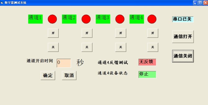

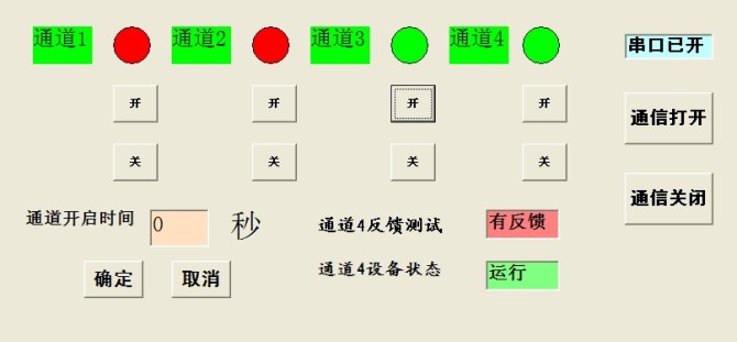

//---------- VB代碼--------------------------------------------------------
Private Sub Command1_Click()
On Error GoTo errline:
MSComm1.Output = "1"
Shape1.FillColor = vbGreen
Exit Sub
Exit Sub
errline:
If Err.Number = 8018 Then
Text3.Text = "串口已關"
End If
Err.Clear
End Sub
Text3.Text = "串口已關"
End If
Err.Clear
End Sub
Private Sub Command10_Click()
MSComm1.Output = "5"
MSComm1.Output = "6"
MSComm1.Output = "7"
MSComm1.Output = "8"
Shape1.FillColor = vbRed
Shape2.FillColor = vbRed
Shape3.FillColor = vbRed
Shape4.FillColor = vbRed
MSComm1.PortOpen = False
Timer2.Enabled = False
Timer3.Enabled = False
Text3.Text = "串口已關"
errline:
Text3.Text = "串口已關"
End If
Err.Clear
End Sub
Private Sub Command11_Click()
If Text1.Text < 0 Then
Text1.Text = 0
End If
Timer1.Enabled = True
errline:
If Err.Number = 13 Then
MsgBox ("輸入出錯")
Text1.Text = 0
End If
Text1.Text = 0
End If
errline:
MsgBox ("輸入出錯")
Text1.Text = 0
End If
End Sub
Private Sub Command12_Click()
Text1.Text = 0
Timer1.Enabled = False
Text1.Text = 0
End Sub
Private Sub Command2_Click()
Exit Sub
Exit Sub
errline:
Text3.Text = "串口已關"
End If
Err.Clear
End Sub
Text3.Text = "串口已關"
End If
Err.Clear
End Sub
Private Sub Command3_Click()
MSComm1.Output = "2"
Shape2.FillColor = vbGreen
Exit Sub
Exit Sub
errline:
Text3.Text = "串口已關"
End If
Err.Clear
End Sub
Text3.Text = "串口已關"
End If
Err.Clear
End Sub
Private Sub Command4_Click()
Exit Sub
Exit Sub
errline:
Text3.Text = "串口已關"
End If
Err.Clear
End Sub
Text3.Text = "串口已關"
End If
Err.Clear
End Sub
Private Sub Command5_Click()
MSComm1.Output = "3"
Shape3.FillColor = vbGreen
Exit Sub
Exit Sub
errline:
Text3.Text = "串口已關"
End If
Err.Clear
End Sub
Text3.Text = "串口已關"
End If
Err.Clear
End Sub
Private Sub Command6_Click()
Exit Sub
Exit Sub
errline:
Text3.Text = "串口已關"
End If
Err.Clear
End Sub
Text3.Text = "串口已關"
End If
Err.Clear
End Sub
Private Sub Command7_Click()
MSComm1.Output = "4"
Shape4.FillColor = vbGreen
Exit Sub
Exit Sub
errline:
Text3.Text = "串口已關"
End If
Err.Clear
End Sub
Text3.Text = "串口已關"
End If
Err.Clear
End Sub
Private Sub Command8_Click()
Exit Sub
Exit Sub
errline:
Text3.Text = "串口已關"
End If
Err.Clear
End Sub
Text3.Text = "串口已關"
End If
Err.Clear
End Sub
Private Sub Command9_Click()
MSComm1.CommPort = 6
MSComm1.Settings = "9600,n,8,1"
MSComm1.InputMode = comInputModeText
MSComm1.InputLen = 0
MSComm1.PortOpen = True
Timer2.Enabled = True
Timer3.Enabled = True
Text3.Text = "串口已開"
Exit Sub
errline:
If Err.Number = 8013 Then
Text3.Text = "串口已開"
End If
Err.Clear
End Sub
Private Sub Form_Load()
End Sub
Private Sub Text1_Change()
errline:
Text1.Text = "輸入錯誤"
End If
Err.Clear
errline:
Text1.Text = "輸入錯誤"
End If
Err.Clear
End Sub
Private Sub Timer1_Timer()
Text1.Text = 0
End If
Text1.Text = 0
End If
If Text1.Text = 0 Then
Exit Sub
Exit Sub
End If
Text1.Text = Text1.Text - 1
errline:
Text3.Text = "串口已關"
End If
Err.Clear
errline:
Text3.Text = "串口已關"
End If
Err.Clear
End Sub
Private Sub Timer2_Timer()
If MSComm1.Input = "9" Then
Text2.Text = "有反饋"
End If
If MSComm1.Input = "a" Then
Text2.Text = "無反饋"
End If
errline:
Text3.Text = "串口已關"
End If
Err.Clear
Text2.Text = "有反饋"
End If
Text2.Text = "無反饋"
End If
errline:
Text3.Text = "串口已關"
End If
Err.Clear
End Sub
Private Sub Timer3_Timer()
If Shape4.FillColor = vbGreen And Text2.Text = "有反饋" Then
Text4.Text = "運行"
End If
If Shape4.FillColor = vbGreen And Text2.Text = "無反饋" Then
Text4.Text = "故障"
End If
If Shape4.FillColor = vbRed And Text2.Text = "無反饋" Then
Text4.Text = "停止"
End If
Text4.Text = "運行"
End If
Text4.Text = "故障"
End If
Text4.Text = "停止"
End If
End Sub
Private Sub Timer4_Timer()
Timer4.Enabled = False
End Sub
