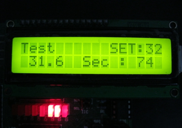

//------AVR代碼-----------------
#include <iom16.h> //1602代碼
#include <intrinsics.h>
#define RS PORTB_Bit0
#define RW PORTB_Bit1
#define EN PORTB_Bit2
#define DATA PORTA
#define busy 0x80
#define DATA PORTA
#define busy 0x80
void delay(uint k)
uint i,j;
for(i=0;i<k;i++)
for(j=0;j<1140;j++);
uint i,j;
for(i=0;i<k;i++)
void wait()
uchar val;
DATA=0xff;
RS=0;
RW=1;
__no_operation();
__no_operation();
EN=1;
__no_operation();
__no_operation();
DDRA=0x00;
val=PINA;
while(val&busy)
val=PINA;
EN=0;
DDRA=0xff;
void writecmd(uchar cmd)
wait();
RS=0;
RW=0;
__no_operation();
DATA=cmd;
__no_operation();
EN=1;
__no_operation();
__no_operation();
EN=0;
void writedata(uchar data)
wait();
RS=1;
RW=0;
__no_operation();
DATA=data;
__no_operation();
EN=1;
__no_operation();
__no_operation();
EN=0;
wait();
RS=1;
RW=0;
__no_operation();
DATA=data;
__no_operation();
EN=1;
__no_operation();
__no_operation();
EN=0;
void displayonechar(uchar x,uchar y,uchar dda)
y&=0x01;
x&=0x0f;
if(y)x|=0x40;
x|=0x80;
writecmd(x);
writedata(dda);
void displaychar(uchar x,uchar y,uchar *p)
y&=0x01;
x&=0x0f;
while(*p!='\0')
if(x<=0x0f)
displayonechar(x,y,*p);
p++;
x++;
y&=0x01;
x&=0x0f;
while(*p!='\0')
if(x<=0x0f)
p++;
x++;
void init1602()
delay(15);
writecmd(0x38);
delay(5);
writecmd(0x38);
delay(5);
writecmd(0x38);
writecmd(0x80);
writecmd(0x01);
writecmd(0x06);
writecmd(0x0c);
//-------------18B20代碼------------
uchar teml,temh;
uchar sign;
uchar Flag_1820Error;
uint tempp; //溫度值
void delay_15us(void) //15us左右
uchar x=27;
while(x)
x--;
void delay_60us(void) //60us左右
uchar x=117;
while(x)
x--;
void init_1820(void)
uchar i;
uint j=0;
PORTC|=(1<<7); //"1"
PORTC&=~(1<<7); //"0"
for(i=0;i<8;i++)delay_60us();//480us以上
DDRC&=~(1<<7); //"PINC7 is INPUT"
delay_15us(); //15~60us
delay_15us();
Flag_1820Error=0;
while(PINC&(1<<7))
{ delay_60us();
j++;
if(j>=18000){Flag_1820Error=1;break;}
DDRC|=(1<<7); //PORTC7 is OUTPUT
for(i=0;i<4;i++)delay_60us(); //240us
void delay_5us(void) //5us左右
uchar x=7;
while(x)
x--;
void write_1820(uchar x)
uchar m;
for(m=0;m<8;m++)
if(x&(1<<m)) //寫數(shù)據(jù),從低位開始
{PORTC&=~(1<<7);delay_5us(); //"0",5us
PORTC|=(1<<7); //write"1"
delay_15us(); //15~45us
delay_15us();
delay_15us();
else
{PORTC&=~(1<<7);delay_15us();//"0",15us
delay_15us(); //write"0"
delay_15us();
uchar read_1820(void)
uchar temp,k,n;
temp=0;
for(n=0;n<8;n++)
delay_5us();
delay_5us();
k=(PINC&(1<<7)); //讀數(shù)據(jù),從低位開始
if(k)
temp|=(1<<n); //read"1"
else
temp&=~(1<<n); //read"0"
delay_15us(); //45us
delay_15us();
delay_15us();
return (temp);
uint read_temper(void)
uchar TX; //小數(shù)位
uchar TZ; //整數(shù)位
init_1820(); //復(fù)位18b20
write_1820(0xcc); // 發(fā)出轉(zhuǎn)換命令
write_1820(0x44);
init_1820();
write_1820(0xcc); //發(fā)出讀命令
write_1820(0xbe);
teml=read_1820(); //讀數(shù)據(jù)byte1
temh=read_1820(); //byte2
TX=teml&0x0f;
temh=temh<<4;
temh|=(teml&0xf0)>>4;
TZ=temh;
tempp=TZ*10+TX;
return tempp;
uchar m;
for(m=0;m<8;m++)
delay_15us();
delay_15us();
else
delay_15us();
uchar temp,k,n;
temp=0;
for(n=0;n<8;n++)
delay_5us();
delay_5us();
if(k)
else
delay_15us();
delay_15us();
return (temp);
write_1820(0x44);
init_1820();
write_1820(0xbe);
TX=teml&0x0f;
temh=temh<<4;
TZ=temh;
tempp=TZ*10+TX;
return tempp;
//---串口代碼------------
#define UDRE 5
#define RXC 7
#define RXC 7
void serial_init() //串口初始化
UCSRB=0x00;
UCSRA=0x02;
UCSRC=0x06;
UBRRL=0x67;
UBRRH=0x00;
UCSRB=0x18;
UCSRB=0x00;
UCSRA=0x02;
UCSRC=0x06;
UBRRL=0x67;
UBRRH=0x00;
UCSRB=0x18;
void serial_sendbyte(uchar u)
while(!(UCSRA&(1<<UDRE)));
UDR=u;
UDR=u;
uchar serial_receive()
while(!(UCSRA&(1<<RXC)));
return UDR;
return UDR;
void serial_str(uchar *p)
while(*p)
serial_sendbyte(*p);
p++;
while(*p)
p++;
void serial_sendtemp(uint tt) //發(fā)送溫度值
serial_sendbyte((tt/100)+48);
serial_sendbyte((tt%100/10)+48);
serial_sendbyte('.');
serial_sendbyte((tt%10)+48);
serial_sendbyte('\r');
serial_sendbyte('\n');
//--------------按鍵代碼-------
#define k1 PIND_Bit4
#define k2 PIND_Bit5
void key1()
static uchar i,j;
if(k1==0)
if(i==0)
j++;
if(j>2)
if(k1==0)
i=1;j=0;
tempset++;
if(tempset>50)tempset=0;
else
i=0;
j=0;
if(k1==0)
if(i==0)
j++;
if(j>2)
if(k1==0)
i=1;j=0;
tempset++;
else
i=0;
j=0;
//----------------定時(shí)器代碼--------------
void time0_init() //定時(shí)器1 初始化
TCCR0=0x05; //1024分頻
TCNT0=0x4b;
TIMSK=0x01;
SREG=0x80;
#pragma vector = 0x24
__interrupt void time0_event()
SREG=0x00;
TCNT0=0x4b;
static uchar i;
i++;
if(i==40)
{ i=0;
displayflag=1; //到達(dá)1秒刷屏標(biāo)志啟動(dòng)
sec++;
if(sec==100)sec=0;
SREG=0x00;
TCNT0=0x4b;
static uchar i;
i++;
if(i==40)
{ i=0;
sec++;
if(sec==100)sec=0;
//------------------------主函數(shù)----------------------
#include <iom16.h>
#define uchar unsigned char
#define uint unsigned int
#define light PORTB_Bit7 //過溫報(bào)警閃燈
uchar sec;
uchar displayflag; // 刷屏標(biāo)志
uint tempset=25; //溫度設(shè)定
#include"1602.h"
#include"18b20.h"
#include"serial.h"
#include "time1.h"
#include "key.h"
#include"18b20.h"
#include"serial.h"
#include "time1.h"
#include "key.h"
void port_init()
PORTA=0xff;
DDRA=0xff;
PORTB=0xff;
DDRB=0xff;
PORTC=0xff;
DDRC=0xff;
PORTD=0xff;
DDRD=0x00;
PORTA=0xff;
DDRA=0xff;
PORTB=0xff;
DDRB=0xff;
PORTC=0xff;
DDRC=0xff;
PORTD=0xff;
DDRD=0x00;
void show_temp(uint k) //顯示溫度值
displayonechar(1,1,(k/100)+48);
displayonechar(2,1,(k%100/10)+48);
displayonechar(3,1,'.');
displayonechar(4,1,(k%10)+48);
void show_sec(uchar k) //顯示秒表
displaychar(7,1,"Sec :");
displayonechar(13,1,(k/10)+48);
displayonechar(14,1,(k%10)+48);
void show_tempset(uchar k) //顯示設(shè)定值
displaychar(10,0,"SET:");
displayonechar(14,0,(k/10)+48);
displayonechar(15,0,(k%10)+48);
void main()
uint TT; //顯示的溫度值
uint kk;
port_init();
serial_init();
time0_init();
delay(1000);
init1602();
displaychar(0,0,"Test");
uint kk;
port_init();
serial_init();
time0_init();
delay(1000);
init1602();
while(1)
TT=read_temper();
show_temp(TT);
serial_sendtemp(TT);
show_tempset(tempset);
if(displayflag==1) //秒鐘變化后才刷屏
show_sec(sec);
displayflag=0;
if(TT>tempset*10) //溫度大于設(shè)定值報(bào)警
kk++;
if(kk>20)
light=~light;
kk=0;
TT=read_temper();
show_temp(TT);
show_sec(sec);
displayflag=0;
kk++;
if(kk>20)
light=~light;
kk=0;
key1(); //按鍵設(shè)定溫度值

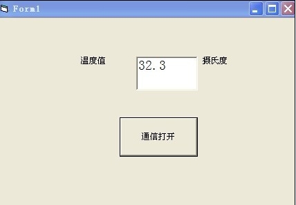

//---------------VB代碼----------
Option Explicit
Private Sub Command1_Click()
MSComm1.CommPort = 6
MSComm1.PortOpen = True
MSComm1.Settings = "9600,n,8,1"
MSComm1.InputMode = comInputModeText
MSComm1.InputLen = 0
End Sub
Private Sub MSComm1_OnComm()
Text1.Text = MSComm1.Input
End Sub
