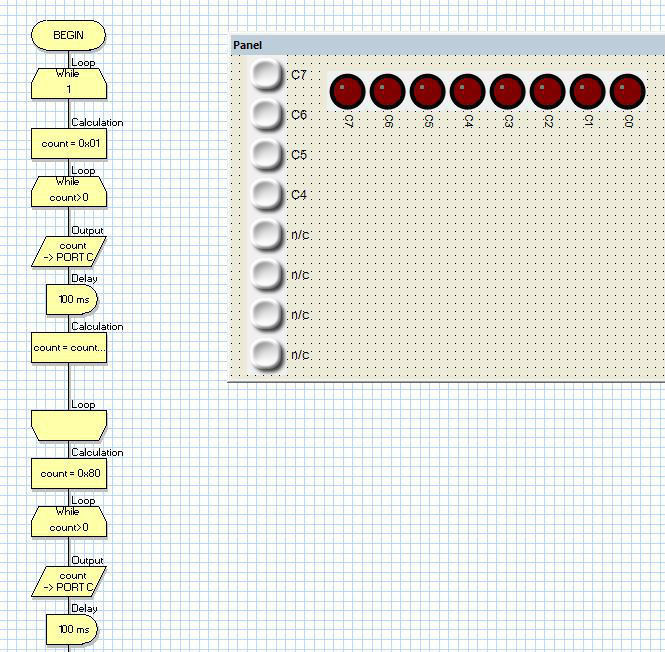

程序介紹:每隔100ms,移動(dòng)一個(gè)燈亮

  //  count = 0x01
  FCV_COUNT = 0x01;
  //Loop
  //Loop: While count>0
  while (FCV_COUNT>0)
   //Output
   //Output: count -> PORT C
   trisc = 0x00;
   portc = FCV_COUNT;
   //Delay
   //Delay: 100 ms
   delay_ms(100);
   //Calculation
   //Calculation:
   //  count = count<<1
   FCV_COUNT = FCV_COUNT<<1;
  //Calculation
  //Calculation:
  //  count = 0x80
  FCV_COUNT = 0x80;
  //Loop
  while (FCV_COUNT>0)
   //Output
   trisc = 0x00;
   portc = FCV_COUNT;
   //Delay
   //Delay: 100 ms
   delay_ms(100);
   //Calculation
   //Calculation:
   //  count = count>>1
   FCV_COUNT = FCV_COUNT>>1;
 mainendloop: goto mainendloop;
