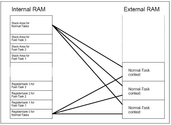

n       Contain a separate register bank and a separate stack area (register banks 1, 2 and 3).(Figure 1)

n       Share a common register bank and a common stack area (register bank 0).
n       The current contents of registers and stack are stored in the external (XDATA) memory during a task change.
