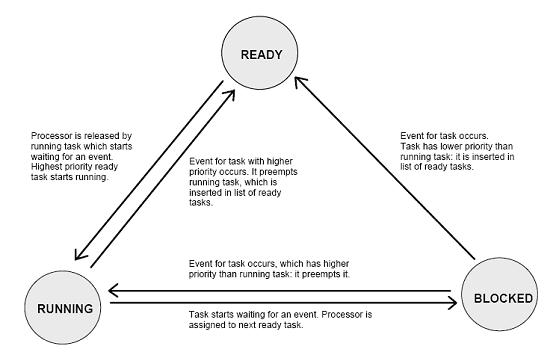

2)       進(jìn)程狀態(tài)(Task states)
RTX-51 recognizes four task states:
1.       READY     All tasks which can run are READY. One of these tasks is the RUNNING (ACTIVE)task.
2.       RUNNING   (ACTIVE) Task which is currently being executed bythe processor. Only one task (maximum) can be in this state at a time.
3.       BLOCKED   (WAITING) Task waits for an event.
4.       SLEEPING  All tasks which were not started or which have terminated themselves are in this state.
3)       進(jìn)程調(diào)度(Task switch)
The RTX-51 system section which the processors assigns to the individual tasks is referred to as the scheduler (also dispatcher).
The RTX_51 scheduler works according to the following rules:
1.       The task with the highest priority of all tasks in the READY state is executed.
2.       If several tasks of the same priority are in the READY state,the task that has been ready the longest will be the next to execute.
3.       Task switchings are only executed if the first rule would have been otherwise violated (exception: round-robin scheduling).
Time-slice task change (round-robin scheduling) are executed if the following conditions are satisfied:
1.       Round-robin scheduling must be enabled (see configuration).
2.       The RUNNING task has the priority of 0 and is currently not executing a floating-point operation (see section "Floating-Point Operations", page 28).
3.       At least one task with the priority zero must be in the READY state.
4.       The last task change must have occurred after the selected system time interval (see system function "os_set_slice"). The system time interval can be changed dynamically during program execution.

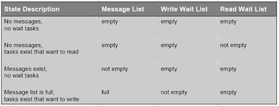

Each mailbox is internally consists of three wait lists.(Figure 2)
Figure 2
1.       Message list
List of the messages written in the mailbox. These comprise a maximum of eight messages.
2.       Write wait list
Wait list for tasks which want to write a message in the message list of the mailbox (maximum 16 tasks).
3.       Read wait list
Wait list for tasks which want to read a message from the message list of the mailbox (maximum 16 tasks).

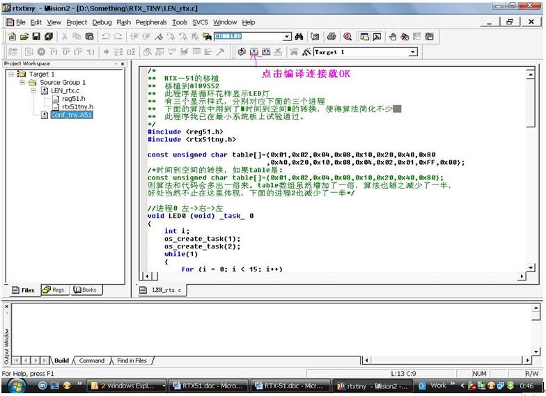

三.RTX51移植
本試驗(yàn)是用的RTX的Tiny版本。也就是說沒有優(yōu)先級(jí)之分,沒有郵箱機(jī)制,沒有動(dòng)態(tài)內(nèi)存的管理。移植它很簡(jiǎn)單,就是配置一下它帶的配置文件,然后和寫好的程序一起編譯連接,連接的時(shí)候加一個(gè)rtxtny參數(shù),意思是說當(dāng)我連接的時(shí)候,我把RTXtiny的庫文件連接上,也就等于是程序和操作系統(tǒng)編譯在一起了。該配置文件能在安裝目的rtxtiny2底下找到。文件名稱為Conf_tny.A51,例如,在我的電腦中,路徑為:D:\Keil\單片機(jī)c語言\RtxTiny2\SourceCode\ Conf_tny.A51。如下圖所示:
由于試驗(yàn)箱里面的芯片是AT89C51,所以要配置Conf_tny.A51的RAMTOP EQU 07F,目的是說配置內(nèi)部RAM為128字節(jié)。
四.源程序代碼:
源程序代碼如下,說明請(qǐng)看代碼里面的注釋。
**  RTX-51的移植
**  移植到AT89S52
**  此程序是循環(huán)花樣顯示LED燈
**  有三個(gè)顯示樣式,分別對(duì)應(yīng)下面的三個(gè)進(jìn)程
**  下面的算法中用到了“時(shí)間到空間”的轉(zhuǎn)換,使得算法簡(jiǎn)化不少
**  此程序我已在最小系統(tǒng)板上試驗(yàn)通過。
#include <reg51.h>
#include <rtx51tny.h>
const unsigned char table[]={0x01,0x02,0x04,0x08,0x10,0x20,0x40,0x80
                                               ,0x40,0x20,0x10,0x08,0x04,0x02,0x01,0xFF,0x00};
/*時(shí)間到空間的轉(zhuǎn)換,如果table是:
const unsigned char table[]={0x01,0x02,0x04,0x08,0x10,0x20,0x40,0x80};
則算法和代碼會(huì)多出一倍來。table數(shù)組雖然增加了一倍,算法也隨之減少了一半,
好處當(dāng)然不止在這里體現(xiàn),下面的進(jìn)程2也減少了一半*/
//進(jìn)程0 左->右->左
void LED0 (void) _task_ 0
     int i;
     os_create_task(1);//創(chuàng)建進(jìn)程1
     os_create_task(2);//創(chuàng)建進(jìn)程2
     while(1)
            for (i = 0; i < 15; i++)
                      P1 = table[i];
                   os_wait(K_TMO,30,0);//等待30*10000微妙 = 0.3秒
            os_send_signal(1);    //發(fā)送Signal信號(hào),激活進(jìn)程1
            os_wait(K_SIG,0,0);   //等待信號(hào)
//進(jìn)程1 全亮->全滅->全亮
void LED1 (void) _task_ 1
     int i;
     while(1)
            os_wait(K_SIG,0,0);
            for (i = 0; i < 3; i++)
                      P1 = table[15];   //全亮
                   P1 = table[16];       //全滅
         os_send_signal(2);
//進(jìn)程2 兩邊->中間中間->兩邊
void LED2 (void) _task_ 2
     int i;
     while(1)
            os_wait(K_SIG,0,0);
            for (i = 0; i < 8; i++)
                   P1 =  table[i] | table[i+7];  //由于table長度多一倍,省去了一個(gè)循環(huán),而且算法也簡(jiǎn)化了。
            os_send_signal(0);
